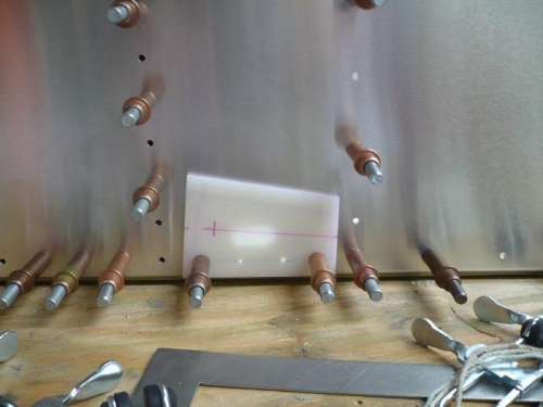

Attach 6-b-3-6 and L-angles 3 of 3
Sandwiched 6-b-3-6 and L-angles, set silver clecoes in every othe holes and drilled #30, Copper clecos, remove silver, drill #30.
Set cable outlet faring.
Trimmed 50mm up at the tangent of the L-angles just ahead of the forward H.T. frame.
Trimmed L-angles
