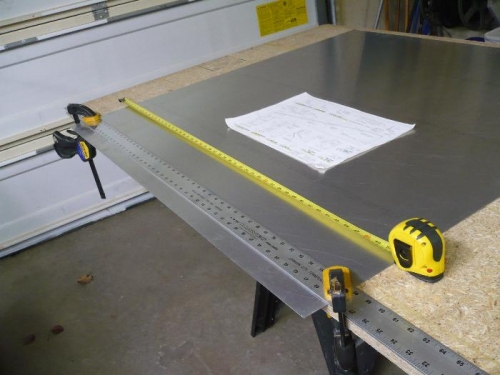

Brief Description:  Cut material for rear longerons & sides
The 0.04 material needed a heavy score and a wodden slapper to get the break going. Cut 8 strips 1220mm long because that is what I had. I will splice to make them the correct length.

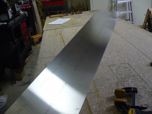

Stood all eight on edge and used a body float vixen file to get them all the same width and then deburred em.
Cut material for access door from full sheet. then layed out one side, cut it then cut the other using the first as a guide.
