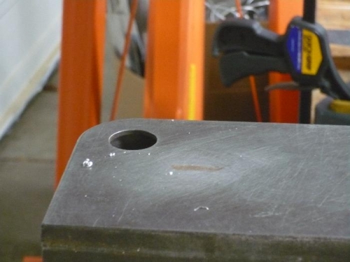

Open up center hole of the nut plate in the Z-Angles around the frame.
Handy hole for drilling in sheet metal is in the T-Bar / anvil I have clamped in my vise. This is one of the handiest tools that was given to me by a very skilled metal worker when he retired.
Place for drill to go

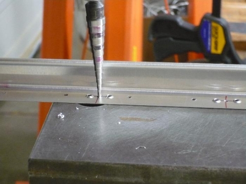

Drill going in four steps

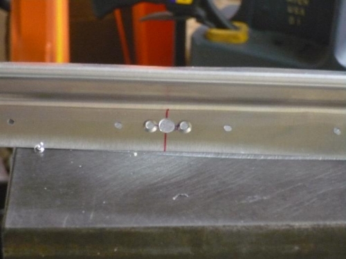

Ta Da
Ta Da
