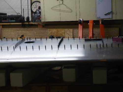

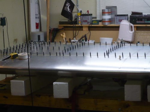

Brief Description:  Prep wing bottom for riveting
Turned up the heat to 80 degrees. Vacumed inside of wing. Set bottom rear skin and clecoed every other hole from the center of the main spar out. Clecoed ribs from the center rib main spar out skiping every other hole.
Riveted tie down.
Bolted Strobe energy pack to main spar tip.
Riveted L-angles for end cap at the main and rear spars.
Riveted Light to fixture. Clecoed fixture to end cap. Clecoed end cap angles and end cap.
