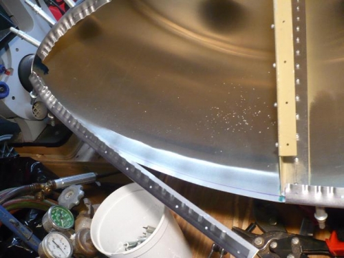

Made final tweaks to the rear top frame piece then marked a line 7mm from the trim edge to line up the rivet holes. Marked and drilled one in the end of the strip then clecoed that one hole. Marked through other holes then center punched and drilled them out.

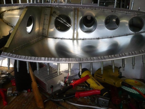

Image 2
Annealed end of strip and formed the leading edge end then clecoed it in place to help finish shape while it is soft.

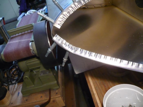

Image 3
Once the end was shaped it was fairly easy to shape the rest and get it clecoed in place.
