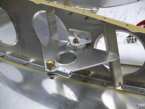

Make tie rod for Right Aileron 1 of 2
Ream bellcrank for 5/16 bolt. Attach rod ends to bellcrank and aileron.

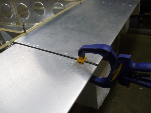

Shim flap 3mm away from rear spar edge.

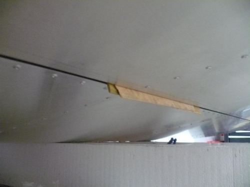

Clamp Aileron to flap for neutral position.
Wedge bellcrank to middle position with L-Angles.
