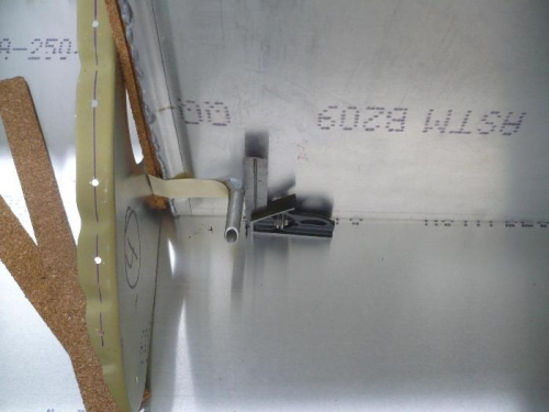

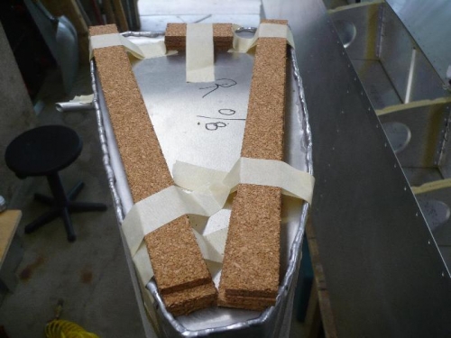

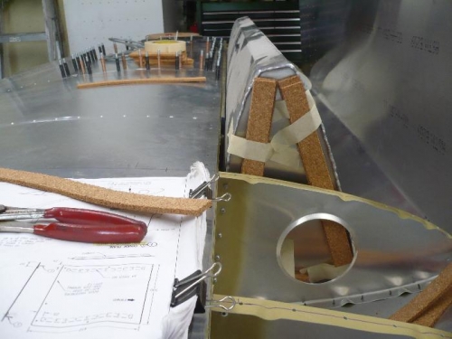

Brief Description:  Fitting fuel tank in right wing 1 of 4
I have some cork from the art store that is 3/16" thick and has no adhesive. Taped 3 thickness to the ends and placed the tank upright in it's location to mark the fuel vent and quick drain inboard/outboard locations.
5/8
5/8" thick cork on ends
Stand it up
Stand it up
Mark the locations
Mark the locations
