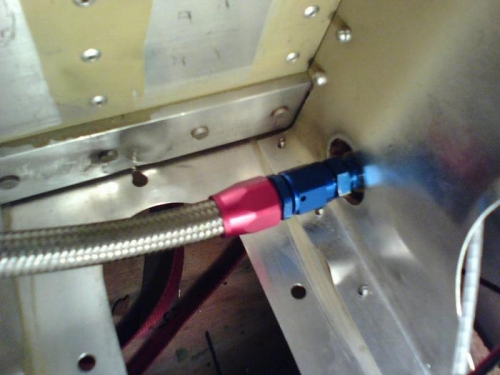

Brief Description:  Fitting and Plumbing Fuel Tank LW
Routed Ground wire from tank, put spiral wrap around the wire to protect it from chafing.
Image 1) Tank in place and wires are in place. They need clamps.
Image 2) First Earl's Swivel Fitting a success. Cut the Earl's Auto-Flex Stainless Braided Hose line to 67" and put on one end. Tapped up other end to close it off and used dawn detergent to get it to slip through the grommets towards the wing root.
Image 3) Tightened fuel line to tank fitting.

Connected to 981606ERL
