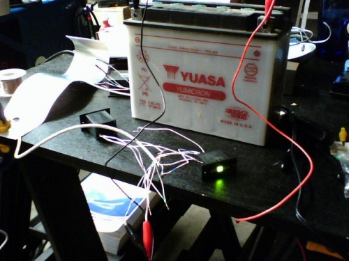

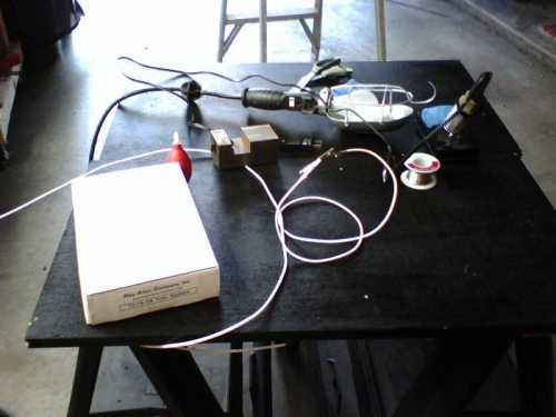

The Ray Allen 5 conductor wire is used here. Got the work area ready then stagger cut the wires and soldered em up. Don't forget to place the shrink tube before soldering. Tested the full circuit and center up the leds.
Getting ready
Getting ready
Third hand aligator clips
Test battery
Test battery
