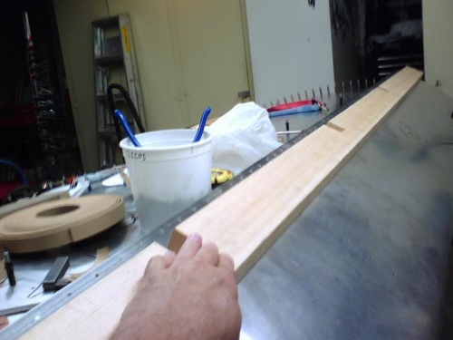

Brief Description:  Fitting Left Fuel Tank
Using 12' long 2x4 to close and open the leading edge skin. It's much faster than using the straps. Set some modeling clay stand offs to measure distance when wing leading edge is closed up. Have two strip thickness of cork on the front top of the tank and it still isn't quite touching yet but it has moved the tank rear ward some. I want to get it in final position before marking the filler hole in the leading edge skin.
Closing skin
Closing skin
