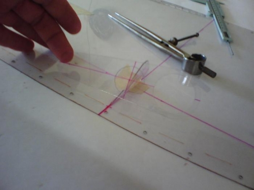

Designing Form for light bubble
Positioned the light base surface against the other template and allowed for the radii of about .5".

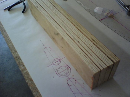

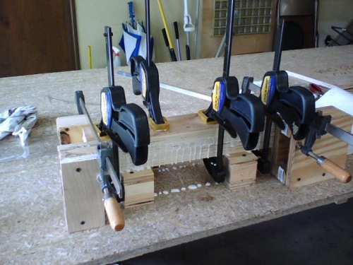

Image 2) Cut four 3/4" x 90mm plywood boards for the glue up.
Glue up the block and cut the shape into it.
