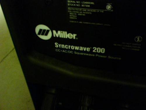

Brief Description:  Welding the fuel tank

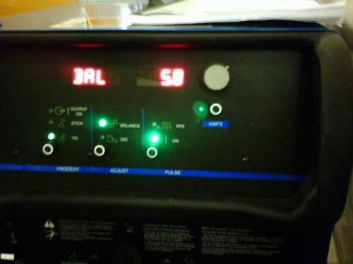

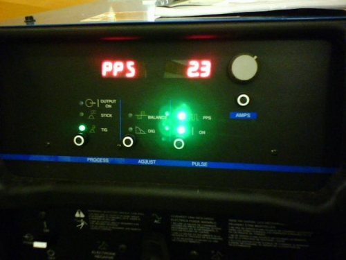

Here are some photos of the Miller Syncrowave 200 I used to weld the .032 6061-T6 tanks and hardware. The torch is an air cooled one and it has not over heated. I pressed the buttons to get the settings pictures, but note this, the square wave pulse was not used. The actual weld settings look like image 2. Bob say I am only drawing about 27-28 amps when welding the .032. This is a fuse weld and can be made very easy using this equipment. The real secret is the 3.25 reading glasses I'm wearing to see this tiny arc.
The equipment
The equipment
Balance set to 5.0
Balance set to 5.0
Pulse set to 2.3
Pulse set to 2.3
