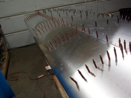

Get all the bottom nose ribs holes filled with clecoes. Then set the wing back down on the risers.

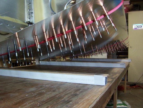

Image 2) Tuck the LE skin under the top rear skin, draw up the straps and silver cleco the spar cap line.
Image 3) Drilled spar cap line to #30 and fitted copper clecoes. Ran silver then copper clecoes up the nose ribs, back to front.
Cleco all bottom nose ribs holes
Silver cleo spar cap line
Read to take down and prime
