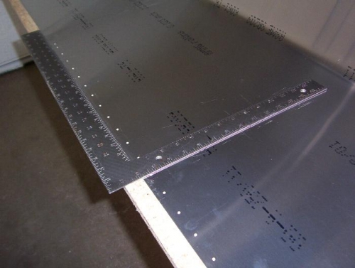

Because this is a fix part the nose ribs already have rivet holes. So I marked the skin on the inside to line the ribs up while drilling.

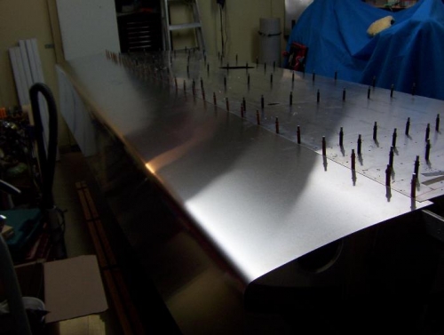

Image 2) Ready to crawl underneath, line up the ribs and drill from below. That Tight Fit Tool is going to come in handy here.
Marking rivet line on inside
Ready to back drill
