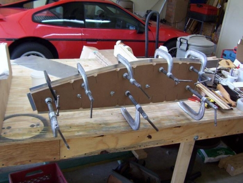

Brief Description:  Forming wing ribs
When the metal is about 60 degrees it begins to be more wavy, that is the time to begin putting in the crimps. I just used the handle of a small hammer as a forming tool and tapped it into the reliefs, just like it showed on the "Scratch Building Basics for Metal Aircraft" DVD from HomeBuiltHelp.com
Tap, don't slam
Tap, don't slam

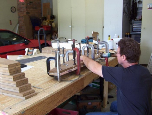

Position for putting in the crimps

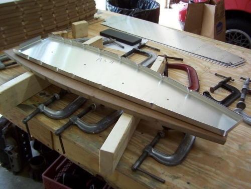

Finished rib
Finished rib
