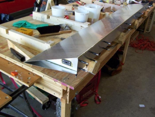

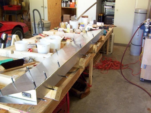

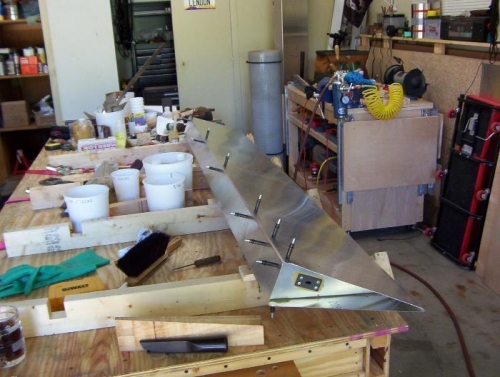

Assemble and rivet Flaps Step 2 - 4
Step 2, top row leading edge of flap. cleco pattern Rib 4, rib 3, rib 5, rib 2, rib 6, rib 1.
3 rd step, Flip part and add clecos to the flap top forward row using the same pattern. The cleco the bottom hole of the flap leading edge.
Step 4 Flip part, remove clecos from the bottom and fixture in place.
