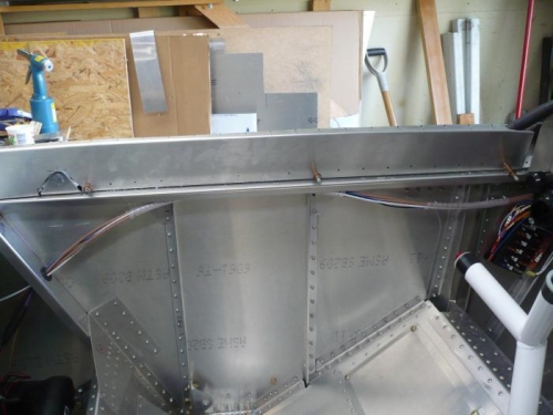

Opened 3 holes to rivet size and clecoed the flashing in place. Drilled out the rest of the holes in the flashing and clecoed the whole flange.

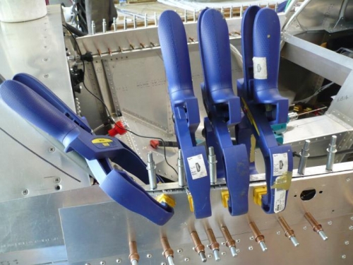

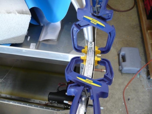

Clamped the inner and outer together at the top and pilot drilled the top flange to the .04" L-Angle.
Had to increase the number of clamps as I got closer to the front hoop.
