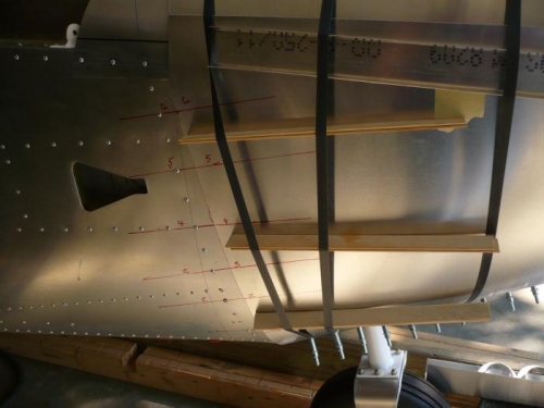

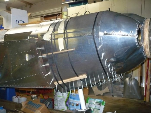

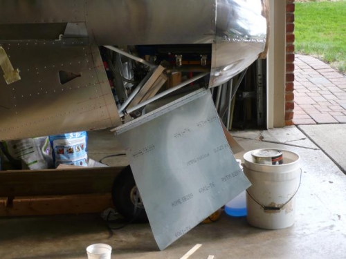

Layout and trim rear lower cowl panels
Trimmed the rear panels then drill holes 75 mm spacing for silver clecoes. Left alone the top holes they will be transfered from the upper panel once they are overlapped.
