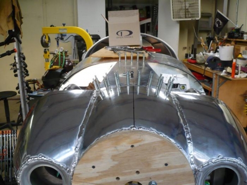

Rolled in the joggle around the perimeter of the nose bowl. Used masking tape to protect the surface and it came out real nice.

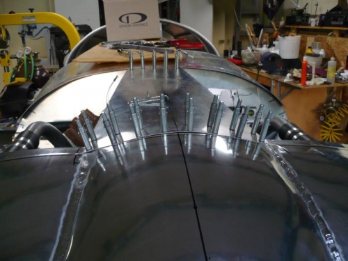

Shaped L angle to hold the arcs in the lower and upper cowl and attached them to tha panels with silver clecoes.

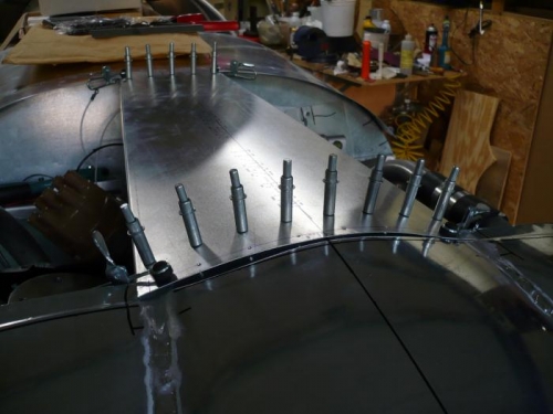

Attached the upper cowl panel to the fuselage and the nose bowl with silver clecoes.
