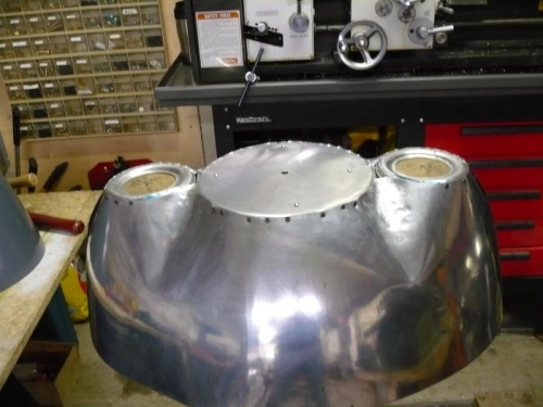

Brief Description:  Tune up front face of lower nose bowl

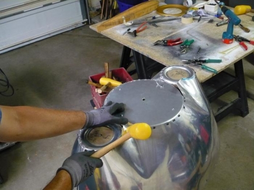

The last form tucks the material out of the slipstream. First stretch with english wheel and 1" radius planishig hammer, then happer the metal in to the station buck. Have to be careful here because you are stretching the material.
Now its time to tack it all up.
