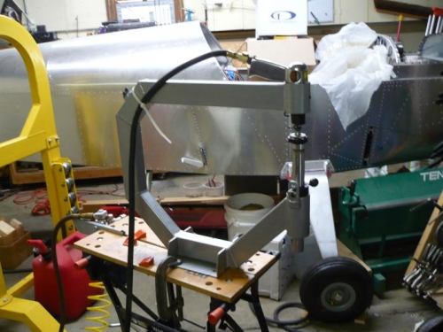

Wheeled what I could then it was time to pull out and setup the planishing hammer to turn out the shape.
Setting up the planishing hammer I had to run out and get some leveling sand to fill the frame with. Filling the frame helps reduce the ringing sound.
You can see the turn, shape change here. See the 3 funnel shapes, one large in the middle and one smaller on each end.
