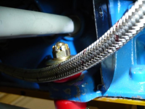

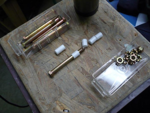

Made the soft plastic bushings from some scrap pvc I found at Home Depot. The gave it to me and thanked me for taking their trash. Torqued the bolts at the firewall and used torque seal to mark em. Torqued the engine mount bolts and pinned em.

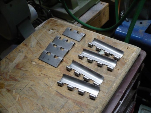

Cut and bend the hinges and pins for the brake pedals.
