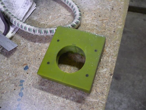

Drilled and tapped the holes for the bottom of the bearing blocks.
Set everything back up on the mill and enlarged the hole for the tube .010"
Clamped and bolted it back to the fuselage and now it has no friction.
