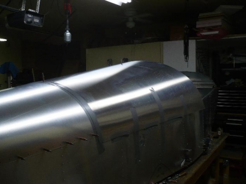

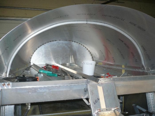

Brief Description:  Positioned forward rear skin
Set skin on rear skin and forward hoops. Positioned rear edge to cover rivet holes. Marked and transfered center hole to the forward skin. Measured 860 forward and drilled another pilot hole in the forward skin on center. That holds the spacing to the rear forward tube.
Skin is ready to mark for rivet lines.

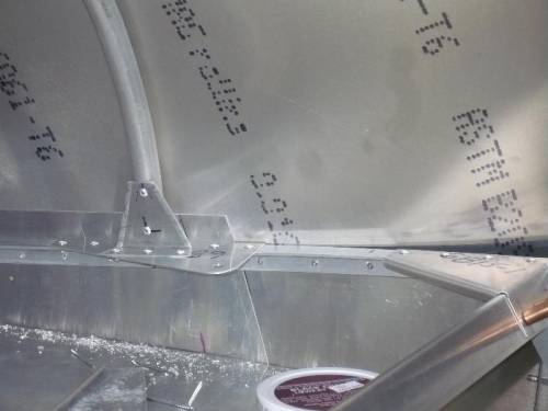

Rear forward tube riveted
Skin positioned
Skin positioned
Rear forward tube positioned
