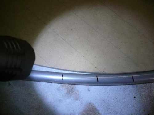

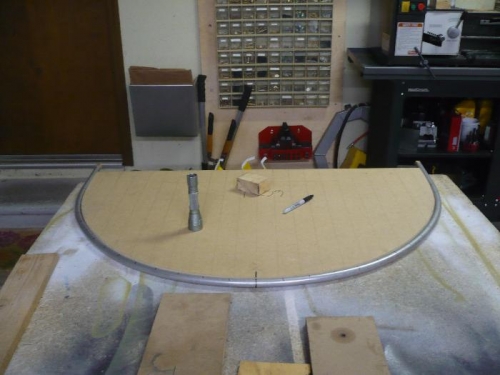

The bending sequence goes like this, start in the center for one bend, one bend to the right one bend to the left. Mark next two bends, one to the right one to the left. Bend last right, bend last left.
Pic 1.

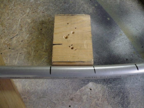

Now look at the piece on the form. See where it touches the form, that's where the next bend goes. It's about one and one half steps back
