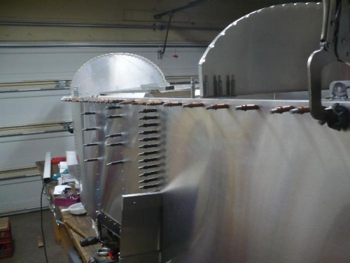

Set center spar rear wing attachment uprights
Opened clearance holes in the wing jig to transfer the hole centers to the wing attachment uprights.
Reset center spar jig and transfered hole centers to the wing attachment uprights.

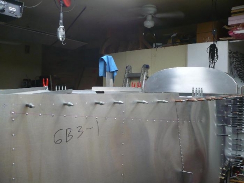

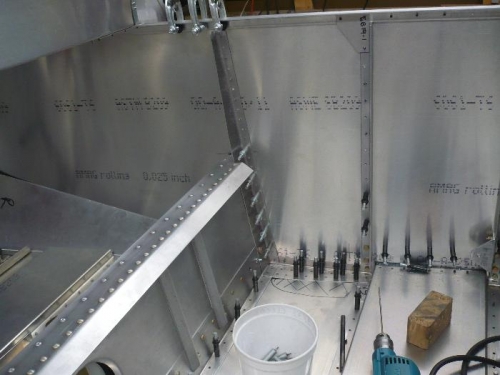

Drilled rivet line along top longeron on the right side.
Drilled and riveted the 6B5-6 on the right side, stopped at the baggage shelf.
Only pilot drilled where the middle top skin attaches.
