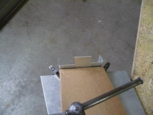

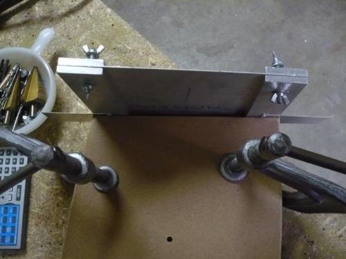

Got these wing jigs from Chuck Z. Had to modify them to work for my wings. Used the rear rib wing form #1 to set the spacing and angles.
All I had to do was remove the rear spar end, adjust for the 3 degree and remount them. Used .025 shims to make up for the rib material thickness.
Also setup and drilled upper engine mounts.
Main spar end w/shims
rear spar end w/shims
