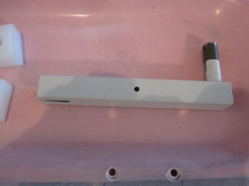

You should have two pieces of plastic 1 1/4” x 1” x 3/4”. Drill 29/64” through both pieces on the 3/4” x 1 1/4” side. Slot from the top of the block to the hole as pictured with a bandsaw or hacksaw.

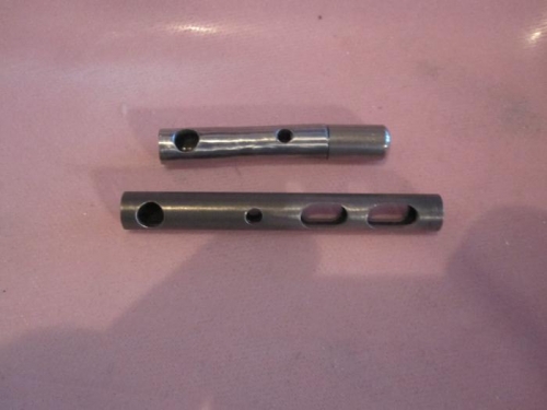

Vans Handle Modification
Mark and remove 3/4” from WD-1022 round section. Cut C-1007 steel tube at the start of the oval holes, removing both oval holes leaving a flush edge. It should be about 2” long after cut. Drill the center of C-1007 using an “F” drill or equivalent to allow tapping to 5/16”-18. Tap down as far a you can to the roll pin. Note: the C-1007 is only about 1 5/8", not 2" per the instructions. I will see if this is an issue. If so, I'll order a new part.

A modified C-1007 with post installed and an umodified C-1007
A modified WD-1002
Delrin blocks fabricated
