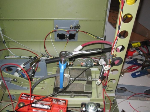

I spent most of the day working on the various power cabling to the battery and the ground power supply. I ran into an issue with the last ground terminal. The cable was too short to reach to terminal tool in the vice. I've been using a 3' piece of pipe to get enough leverage to swage the terminal. Unfortunately, with this last termination, that pipe is too long for use inside the fuselage.
