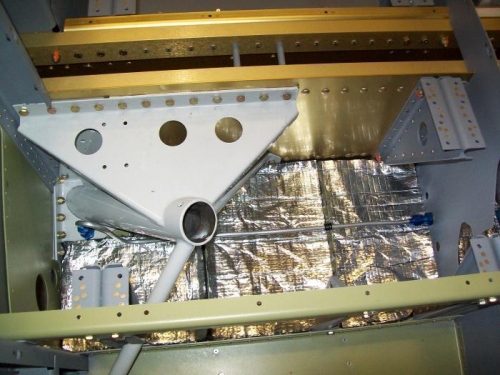

Manual Reference:  36-2
Brief Description:  Brakes lines under the front seats installed
36-3, Steps 4, 5, & 6
Make a brake line from ATO-032X1/4 that connects to the bulkhead fittings and passes through the center of the notches in the F-1084A-L Systems Brackets.
Slip two SB375-4 Snap Bushings onto the inboard end of the brake line. Slip a AN818-4D Nut and a AN819-4D Sleeve onto each end of the brake line.
Flare both ends of the brake line. Attach the brake line to the bulkhead fittings, and slide the snap bushings into the notches in the top of the F-1084A-L Systems Brackets.
Like most things, the first line took me over an hour to get correct. The second one took about fifteen minutes. Getting the compound curves around the gear mount gave me the most trouble.
36-3 Completed per plans.
Left brake line
Left brake line
Right brake line
Right brake line
