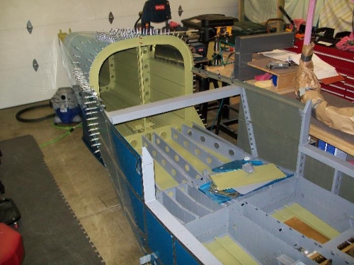

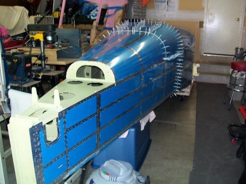

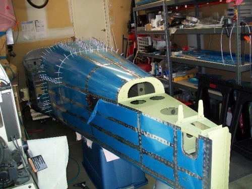

Brief Description:  Mounting the tailcone to the fuselage (part 2)
32-3, Steps 1, 2, 3, & 4
Remove the F-10068 Bulkhead from the tailcone and cleco it to the aft flanges of the F-1019, F-1020, and F-1021 Baggage Ribs. Cleco the tailcone skins to the mid fuse skins. All of the mid fuse skins are clecoed to the outside of the tailcone skins. Final-Drill #30 the holes common to the aft flange of the F-1 019, F-1020, and F-1021 Baggage Ribs and the F-1006B Bulkhead.
The F-1046-R Mid Fuse Longeron fits on top of the F-1032-R Tailcone Longeron. Make sure the vertex of the two longerons are aligned. then clamp them together. Match-Drill the four #30 holes in the aft end of the mid fuse longeron into the tailcone Iongeron using a #30 drill, then final-drill with a #12 drill. Drill and bolt the two aft most holes first, then uncleco the upper portion of the F-1006E Bulkhead to gain access for drilling and bolting the two forward holes.
Repeat this step for the left longerons.
32-3 Completed per plans.
32-4, Steps 1, 2, & 3
Fabricate shims to fit between the F-1074 Tailcone Forward Top Skin and the aft ends of the F-1046 Middle Fuselage Longerons. Cleco the F-1074 Tailcone Forward Top Skin to the Tailcone. Match-Drill #40 the holes of the F-1070-L Mid Side Skin and the three holes of the F-1074 Tailcone Forward Top Skin into the F-1046-L Middle Fuselage longeron. Repeat for the F-1046-R Middle Fuselage longeron on the right side of the fuselage.
