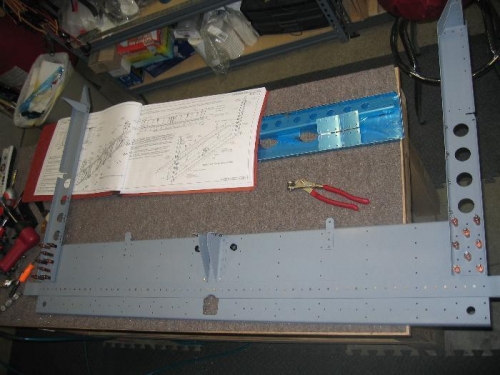

Van's sent a AN3 bolt to replace the rivet that was missing in the spar. I installed the bolt.
25-7, Steps 4, 5, 6, &7
Riveted the nutplates to the bulkhead side channels and the idler arm brackets. Riveted the rear spar attach bars, crotch strap lugs, and the idler arm brackets to the rear spar bulkhead. Riveted the gussets to the bulkhead side channels. Installed the snap bushings into the rear spar bulkhead.
25-8, Steps 1, 2, 3, 4, &5
Match drilled all the common holes on all parts. Deburred, cleaned, and primed.
Completed rear spar bulkhead

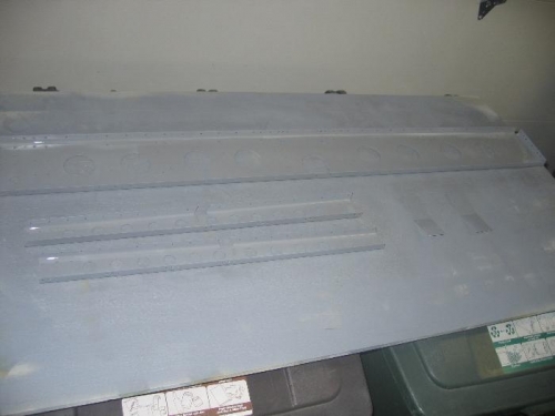

Fuselage bulkhead parts primed
