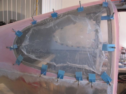

Brief Description:  Rear Windows
Janice assited me in putting in the rear windows. I used Lord 4545a/e ureathane adhesive instead of the weld-on. I had to shim the left window so that that forward edge is flush with the fiberglass that was added to the cabin cover yesterday. Which I might add, turned out much better than anticipated. Like most tasks in building the RV-10, the anxiety makes things more difficult than they usually turned out to be.
Left Rear Window
Left Rear Window
Right Rear Window
Right Rear Window
