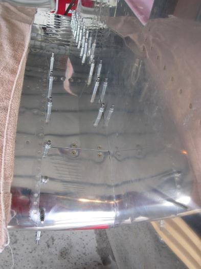

Brief Description:  Right Wing Root Faring
44-6, Step 3
Attach the F-1099B Lower Wing Root Fairing to the T-100SB Shim, T-1001-R Fuel Tank Skin, F-1076 Center Bottom Skin, and to the W-1004-R Bottom Inbd. Wing Skin. Match-Drill #40 and cleco the tank skin at the five locations using the 3/32 holes in the lower wing root fairing as guides.
44-9, Step 1
Align the F-1099A Upper Wing Root Fairing to the inboard edge of the W-1002-R Top Inboard Wing Skin, to the T-1001-R Fuel Tank Skin and to the T-1005-RIT-1005B Tank Attach Bracket and Shim. Inspect the upper wing root fairing in the area of the F-1099C Wing Walk Spacer and adjust the spacer if/as req'd. When satisfied attach the upper wing root fairing. Match-Drill #40 and cleco the F-1099E-R, F-1099F-R, and F-1099H-R Wing Root Fairing Supports and the fuel tank skin using the holes in the upper wing root fairing as guides.
The right side came out much better than the left. I'm going to order another skin for the left and re-do it for a better fit.
Right Wing Root Fairing Clecoed
