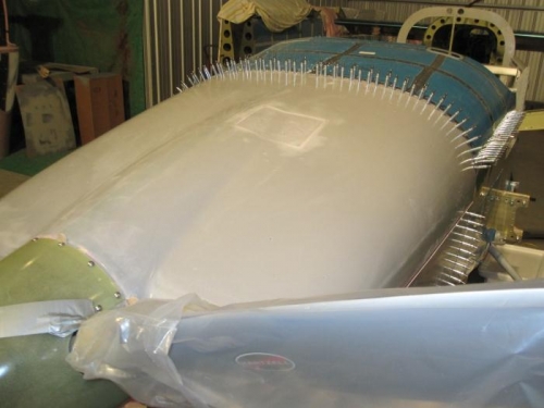

Top Cowl Rivet line drilled and clecoed

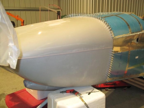

Left side of bottom cowl rivet line drilled and clecoed
