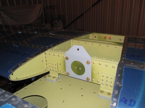

11-05, Steps 4 & 5
Bolt the VS-1016 Vertical Stabilizer Attach Bracket to the HS-1002 Front Spar.
Final-Drill #12 the top two 3/16 holes in the rear spar doubler. Bolt the vertical stabilizer to the F-1012 Aft Fuselage Bulkhead Assembly using the upper two AN3 bolts. Final-Drill #12 the four remaining 3/16" holes and then machine countersink the two bottom holes. Install the hardware. Match-Drill #30 and final-drill #12 where called out, then install the corresponding hardware.
11-06, Step 1
Bolt the vertical stabilizer to the VS-1016 Vertical Stabilizer Front Spar Attach Bracket with the hardware
Vertical Stabilizer Attached
Stabilizer Attach Bracket Installed
