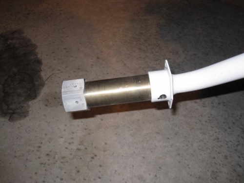

46-4, Steps 1, 2, 3, & 4
Slide the U·1 001-L Main Gear Leg into the WD-1 021-L Left Landing Gear Mount. A holes is drilled through the upper end of the landing gear mount socket. The hole on the top side of the socket is drilled to final size while the corresponding hole in the bottom side is drilled undersize. Align the hole in the main gear leg with the hole in the top side of the socket.
Remove the U-1001-L Main Gear Leg from the WD-1021-L Left Landing Gear Mount and deburr the holes.
Apply a film of wheel bearing grease to the surfaces of the U-1 001-L Main Gear Leg that are not powder coated and that will contact the WD-1 021-L Left Landing Gear Mount socket. Slide the main gear leg into the left landing gear mount socket. then secure the main gear.
Slide one of the U-1003 Brake Mounts onto the U-1001-L Main Gear Leg axle. The hole on one side of the brake mount is still undersize and needs to be final-drilled. Align the holes in the brake mount with the holes in the axle, insert a 3/8" drill bit through the assembly, and final-drill the smaller hole. Remove the brake mount and deburr the holes.

Left Main Gear
Left Main Gear
Right Gear Mount Drilled
