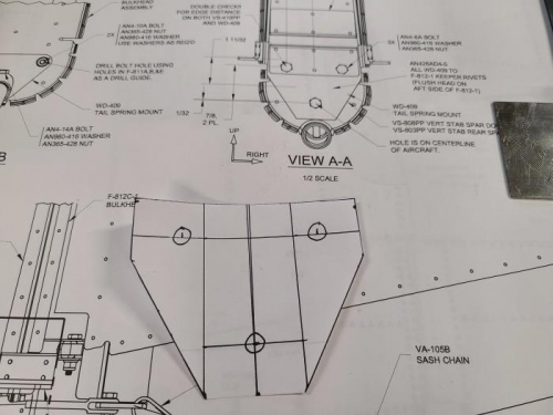

Today I made a template to locate the mounting holes in the vertical stabilizer rear spar. I took measurements from the plans and made a paper template. I'm still not sure about edge distance on the top holes so I have not drilled them yet.
