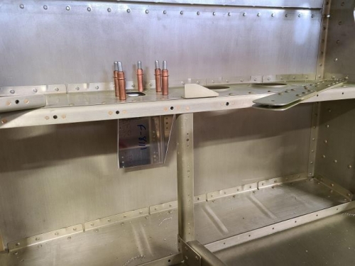

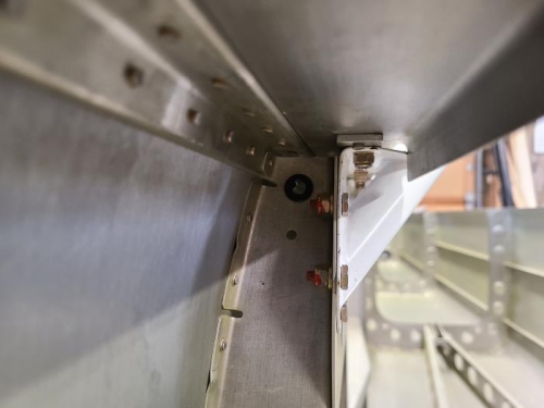

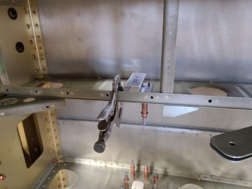

Brief Description:  Ensuring QB Fuselage is Complete
Today I continued with the verification of the QB fuselage. I found a couple of things that needed to be done. Number one was drilling the holes for the brackets for the manual aileron trim. The second item was enlarging holes in a couple of the cabin bulkheads for the static line to pass through. I was initially concerned about getting access to those holes but it turned out to be no big deal. I enlarged them with a unibit and then installed snap bushings.
