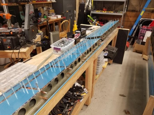

Brief Description:  Building the Flaps
I started today by bending the FL-706B bracket. That went well. Both brackets came out to 6.3 degrees as called out in the plans. I used a digital level to measure the angle.
I then moved on to assembling the flaps. I clecoed the bottom skin on and was about to cleco the top skin on and rivet the line of rivets that join the two as called out in the plans. That was when I realized that the plans don't tell you to rivet the end of the ribs to the bottom skin first. There is no way to access that once the skins are riveted together. Thankfully I realized it and installed those rivets.
Finally, I clecoed on the top skin in preparation for riveting tomorrow.
