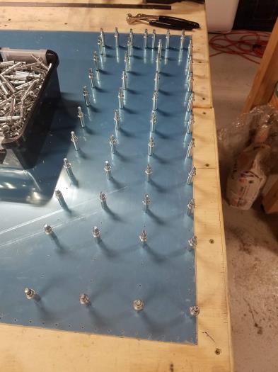

My long straight rivet sets came today so it was back to the shop. I already had the wing walk doublers laid out so I finished those. I put the wing walk doublers under the W-702 skins as called out in the manual and then clamped them to the table. Starting in the center I started match drilling holes using the skin as a guide and putting clecos in every hole. Once I had drilled half the holes and had clecos in them I went back and drilled the other half of the holes.

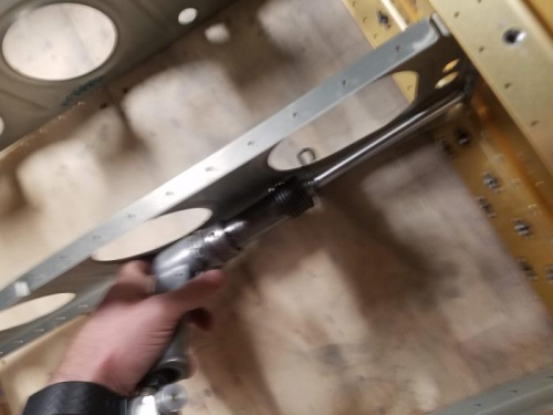

After I finished drilling the wing walk doublers I moved my tables back to the long configuration to support the wing spars again. With the 7 inch long straight rivet set I had plenty of room to flex the ribs out of the way and all my rivets came out really well. I wish I would have know this trick before trying to use the double offset! I have two ribs left and the right wing will have all of the ribs attached.
