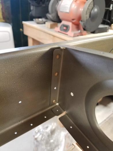

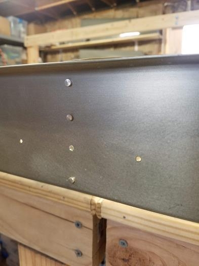

Today I finished riveting all the ribs to the rear wing spars. It went really well with the squeezer. After I was finished with that I fabricated the mounting brackets for my wing stand. Then I put the wings back on the wing stand.

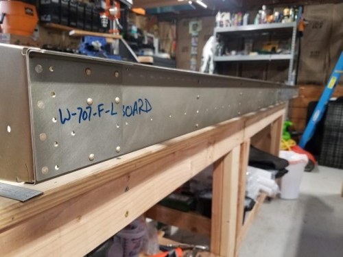

I'm still waiting on my straight rivet sets to finish riveting the main spars to the ribs so I decided to skip ahead a little bit. I fabricated the wing walk doublers out of the provided aluminum sheet. I used a cut off wheel in my Dremel to cut them to approximate length and then used the bandsaw to finish cutting them to size. I cleaned up all the edges and then lined up the one for the right wing under the W-702 skin for the right wing. Now they are clamped to the table waiting to be drilled.
