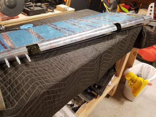

Date:  10-7-2018
Number of Hours:  1.50
Manual Reference:  Emp 6-13
Brief Description:  Finishing the Elevators
I began rolling the leading edges of the elevator. I used a closet rod with sockets JB welded to the inside as my rod. It worked really well. I was able to roll the edges without getting the roll too tight and had plenty of leverage with the socket wrenches.
