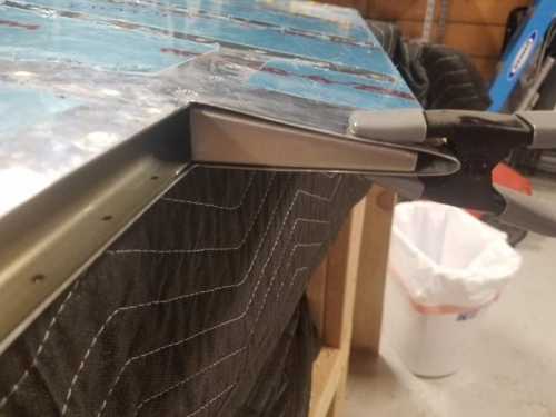

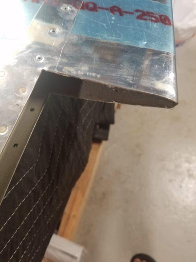

Brief Description:  Riblet Fabrication
Today I fabricated the riblet for the left elevator to close out the skin against the trim tab. I am going to blind rivet the riblet so that the riblet fills the skin void just as the bent tabs would have. The riblet has been cut and fit to the skin. Next step is drilling the holes for the rivets and priming the riblet.
