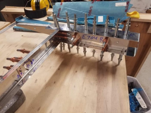

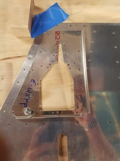

Tonight I finished deburring and dimpling the stiffeners and the skins where the stiffeners attach to them.

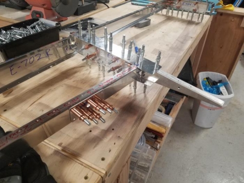

After that I moved back to preparing the right and left elevators. I have been doing the steps on both elevators at the same time instead of doing one and then going back to the other. This way I am doing all of the same steps all at once. It seems to streamline it for me.
Tonight I unclecoed the E-713s and set aside the E-714s. Then I clecoed the E-703, E-704 and E-713 subassemblies to the E-702 spars. I clecoed the E-709 root rib to the right elevator and the E-705 root rib to the left elevator That was it for tonight. I’m ready to match drill these tomorrow.
