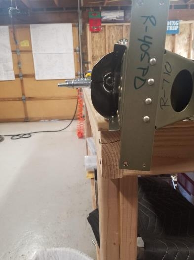

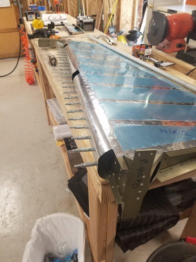

Brief Description:  Completing the Leading Edge of the Rudder
I continued working on forming the leading edge of the rudder. I was able to get the edges to meet but the holes still do not line up without a lot of stress. I'm going to have to continue to massage the bends to get the holes to line up.
