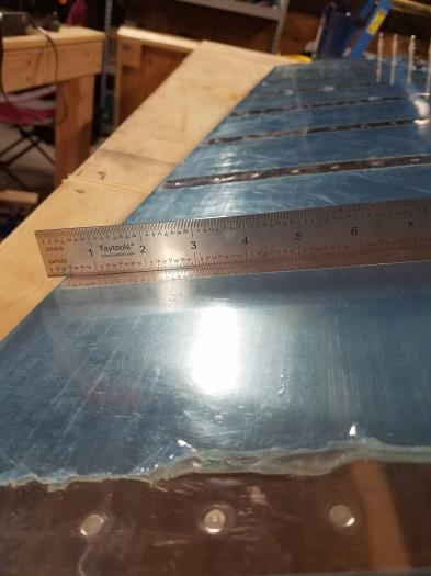

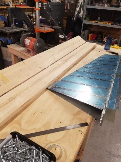

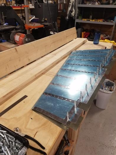

Brief Description:  Bending the rudder trailing edge
I managed to bend the rudder trailing edge today. It took me longer than I figured it would but it came out well. I built the fixture in the plans out of 2x8x8 boards and hinges. It didn’t get completely to a flat surface as the plans call out. I ended up using the hand seamer (covered with duct tape) to finish the bend. It came out great! A perfect bend.
