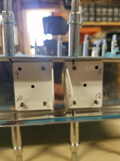

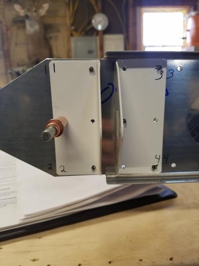

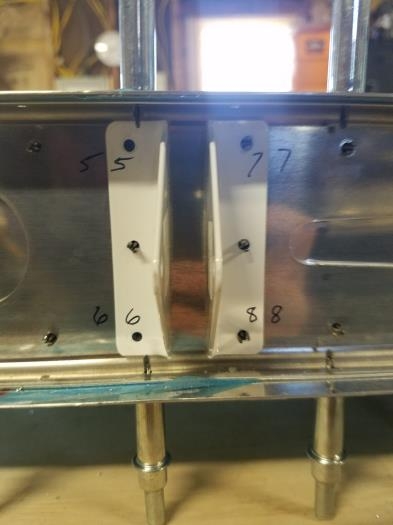

Brief Description:  Drilling and Dimpling Vertical Stabilizer
Today I finished drilling the horizontal stabilizer. I match drilled all the holes in the VS-801PP skin to the skeleton. I then disassembled everything deburred all the parts. I dimpled the VS-801PP skin using the C-frame dimpler and then used a countersink and cage to countersink the holes that needed it on the spar doubler.
