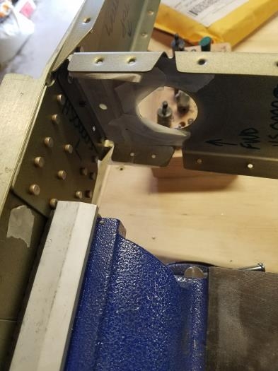

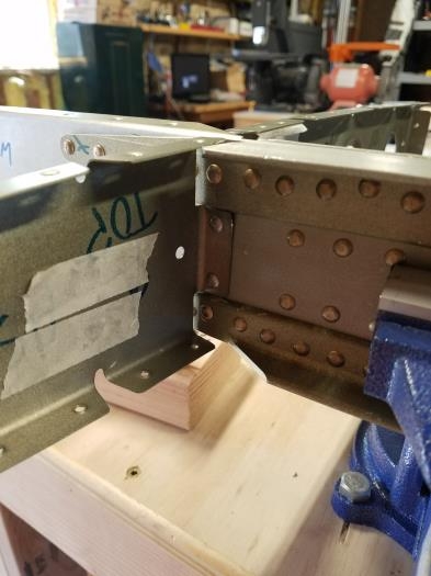

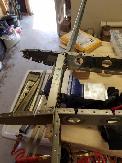

Brief Description:  Riveting the Horizontal Stabilizer
Today I went to rivet the HS-00006 and HS-00005 ribs to the front spar assembly and found that the holes in the spar needed to be drilled to #30 instead of #40 as called out in the plans. I drilled the holes out and then deburred them. Then I riveted the ribs to the front spar assembly.
