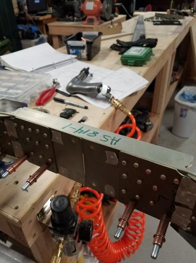

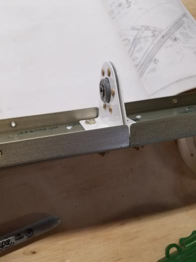

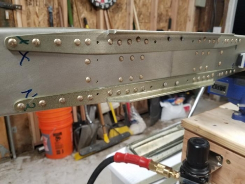

Brief Description:  Riveting the Horizontal Stabilizer
Tonight I kept riveting. I bolted the HS-411PP to the spar. I torqued the bolts to 23 in-lbs. I also riveted the HS-810-1, HS-814-1 and HS-00003 to the HS-702 spars. Most of this riveting was done with the rivet gun. I found that my pneumatic squeezer would not squeeze 4-7 rivets for some reason. I’m sending it back to the manufacturer to be worked on.
